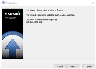

    By the way, I've reached Garmin Support via email and all they did was to tell me to use a tool called "WebUploader" and again, it didn't do anything, just saying that it was already updated to the latest version.
    Screenshots attached.
