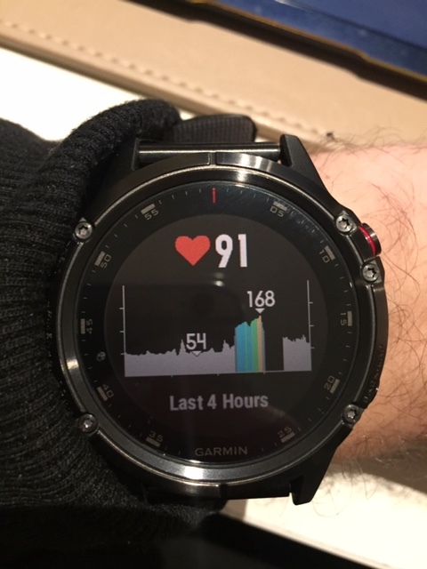

  • Purchased it at beginning of November 2018, doing quick rinsing every time after activity as well and washing once in a 2-3 weeks. So I have made a run today , strap connected without problems , no dropouts during run but after activity is saved and over , no hr detected , when I check the sensor menu, strap is disconnected , but connects straight away as soon as i enter the menu. Wrist Hr does not switch on after inactivity of HR strap, unless you take off your watch and put it back on. I have the red sensor strap non removable.ciq.forums.garmin.com/.../1454526.jpg
