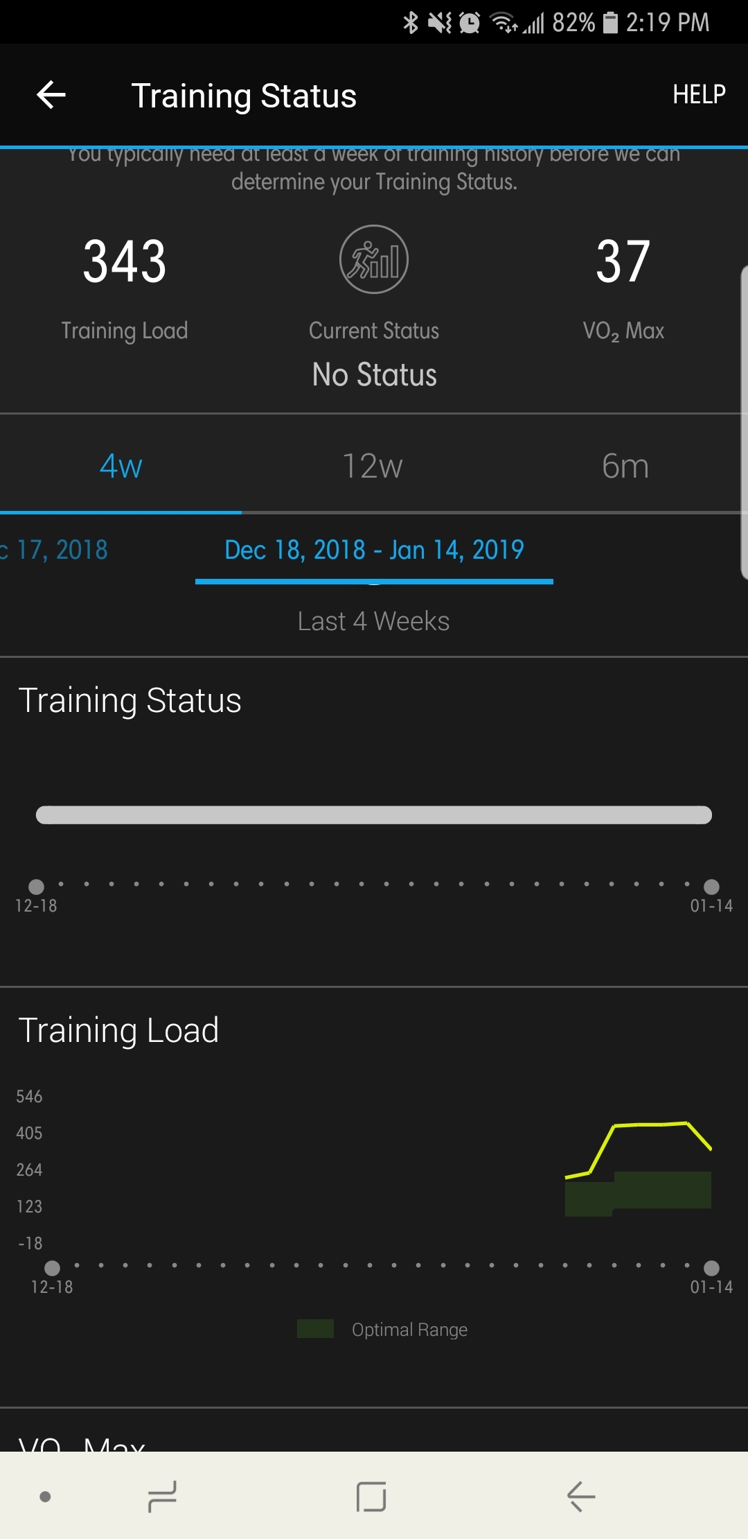

I am just wondering how long until I start seeing training status...
it's been more than a week and still nothing ciq.forums.garmin.com/.../1444301.jpg
  • Training status only updates after multiple outdoor running activities (and cycling? I don't cycle a lot so don't pay attention)
    And sometimes it takes a little extra until it get to know you. As you are above your watch's "training load" preference (lower graph - watch wants you to train less than you do) it might take a while longer.
    But unless you used to be in great physical shape - don't overdo it too much. When ever i start after a break - I try to stay close to the top line of training load graph - so maybe bouncing slightly above if - so if it shows 300 - I might end up at 350 but not much more. Then once you are in a rhythm - watch will give you a wider spread of training load.
