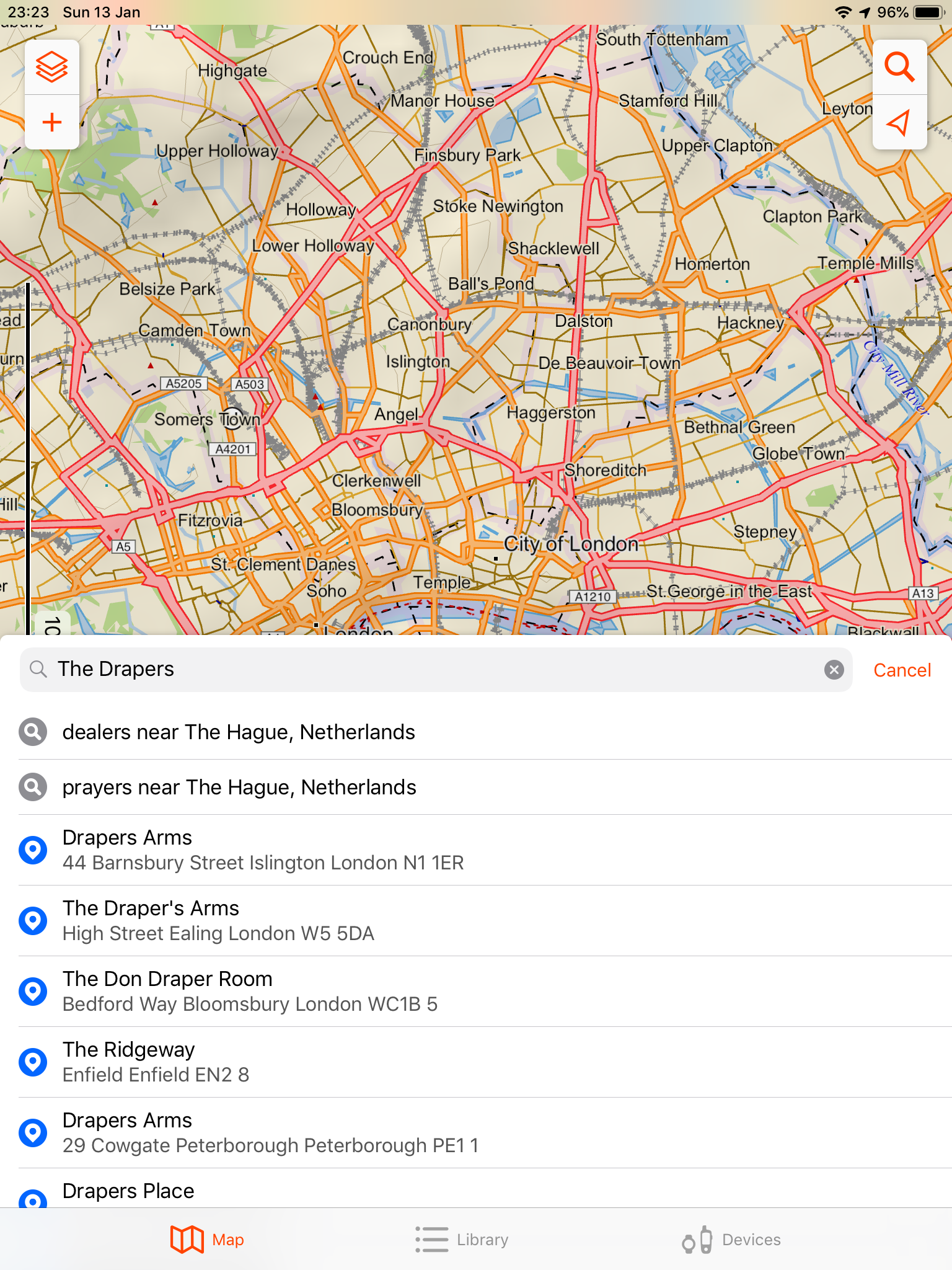

    But getting back to navigating on the fly on the watch... the boozer in question was the Drapers Arms in Islington. If i zoom in on the map, it is clearly labelled as 'The Drapers Arms' (no apostrophe), so it's definitely in Garmin's maps universe. So, being c. 4 miles away, why can't i navigate to it by typing in it's name, exactly as it is labelled? When i select Navigate -> PoI -> Food & Drink -> Spell Search, type in 'The Drapers' (i guess i could have just typed 'Draper') and hit the tick, i just get the page the says 'Around me' and a round and round spin around the circumference... no matter how long i wait. Why can't it blimmin' find it?
  • ....i just get the page the says 'Around me' and a round and round spin around the circumference... no matter how long i wait. Why can't it blimmin' find it?
    Probably because a device with a low energy processor focused on preserving battery life just can’t cope with the density of information in central London. That’s not an excuse, as expectation built up by modern smart phones means that’s what your average punter would reasonably expect, but ‘ya canni defy the laws of physics’. That’s why I defer to getting the smartphone to do the hard calculation/data searching work. I know it’s on my iPad rather than iPhone, but the attached screen shot shows it took me about 5 seconds to find your pub in the Explore app. Once you’ve saved that pub as a Waypoint and sent it to the Fenix 5+, you can put the phone away and just let the watch navigate you from where you are to the pub :) . Ironically, the 5+ is better at doing the navigation than the Explore app, as the watch can route along roads and paths but the Explore app can’t (yet).ciq.forums.garmin.com/.../1443917.png
