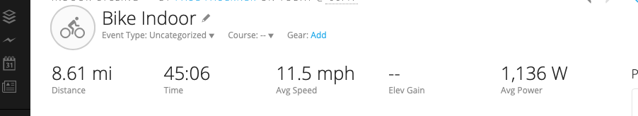

  • Same problem. I wish I could output this average power (especially on a recovery session as this was!)ciq.forums.garmin.com/.../1467951.png
