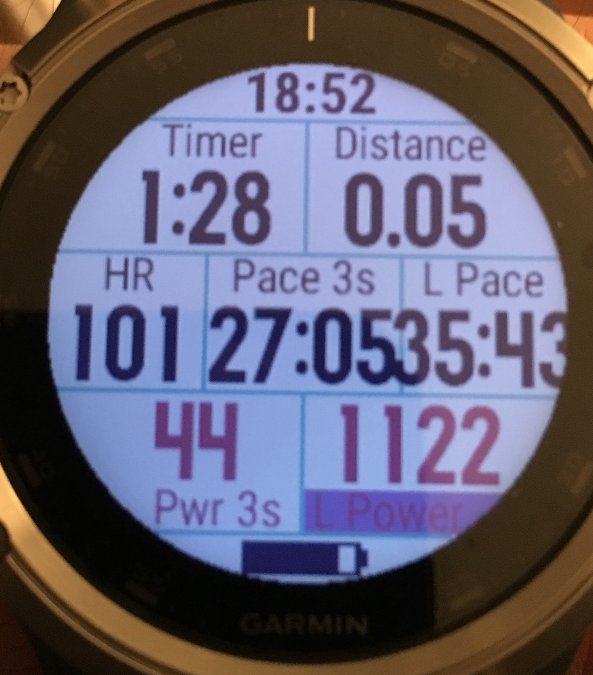

Anyone expeirence abnormally high Stryd Lap power data after upgrading to 6.0 fw? I see the lap power shows in the 1000 to 2000 range while power should be around 230s.

    So the average power and power for each lap after the workout when I look at it from GC or TP looks normal. But it’s when the workout is in session, the power on the datafield is abnormall. I emailed Joop who is the developer of the datarun connect in field and he said that it’s not a easy fix to adjust the lap power issue. This seems more to be a Issue Garmin need to fix in their fw. I attached a screen shot of my watch showing the high lap power. ciq.forums.garmin.com/.../1431286.jpg

  • So the average power and power for each lap after the workout when I look at it from GC or TP looks normal. But it’s when the workout is in session, the power on the datafield is abnormall. I emailed Joop who is the developer of the datarun connect in field and he said that it’s not a easy fix to adjust the lap power issue. This seems more to be a Issue Garmin need to fix in their fw. I attached a screen shot of my watch showing the high lap power.
