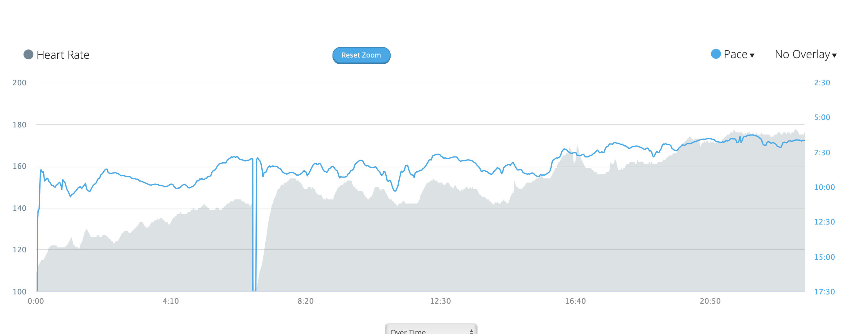

    I just bought a Fenix 5x and ran the lactate threshold test this morning. I warmed up for 12 minutes then began the test. The watch guided me though 3 four-minute bouts of increasing running intensity. Afterward, it alerted to a detected lactate threshold of 88 BPM and 6:54 min/mi.
    The heart rate value is obviously erroneous. Has anyone seen something like this? Should I re-run the test or just do a long tempo run and let it auto detect?
  • The heart rate value is obviously erroneous. Has anyone seen something like this? Should I re-run the test or just do a long tempo run and let it auto detect?
    That heart rate value does seem very off. Before doing the LTHR guided test, had you already set your correct max and resting HR in the watch settings and completed a few runs to get a stable VO2 Max? The LTHR test relies on all these numbers, so if any one is off or not stable it could well lead to a duff output (like any algorithm; rubbish in equals rubbish out).
  • That heart rate value does seem very off. Before doing the LTHR guided test, had you already set your correct max and resting HR in the watch settings and completed a few runs to get a stable VO2 Max? The LTHR test relies on all these numbers, so if any one is off or not stable it could well lead to a duff output (like any algorithm; rubbish in equals rubbish out).
    I've been running consistently with a Vivoactive 3 since May, so I do have a good VO2 max measurement and resting and max HR in my Garmin profile. I believe physiological true-up moved those values on to this watch after setup.
    I did see a temporary HR drop during the warmup period, but I can't imagine that would affect the result. Here's the test.
    ciq.forums.garmin.com/.../1424375.png
