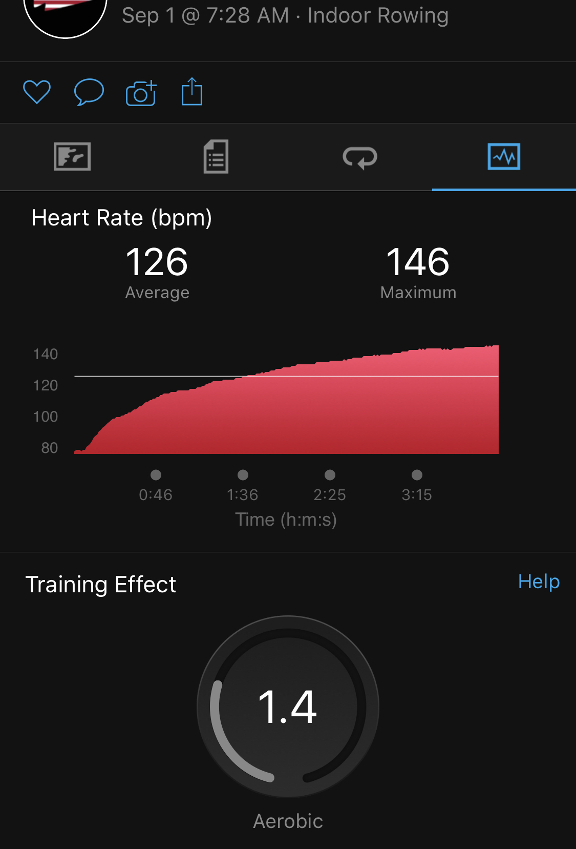

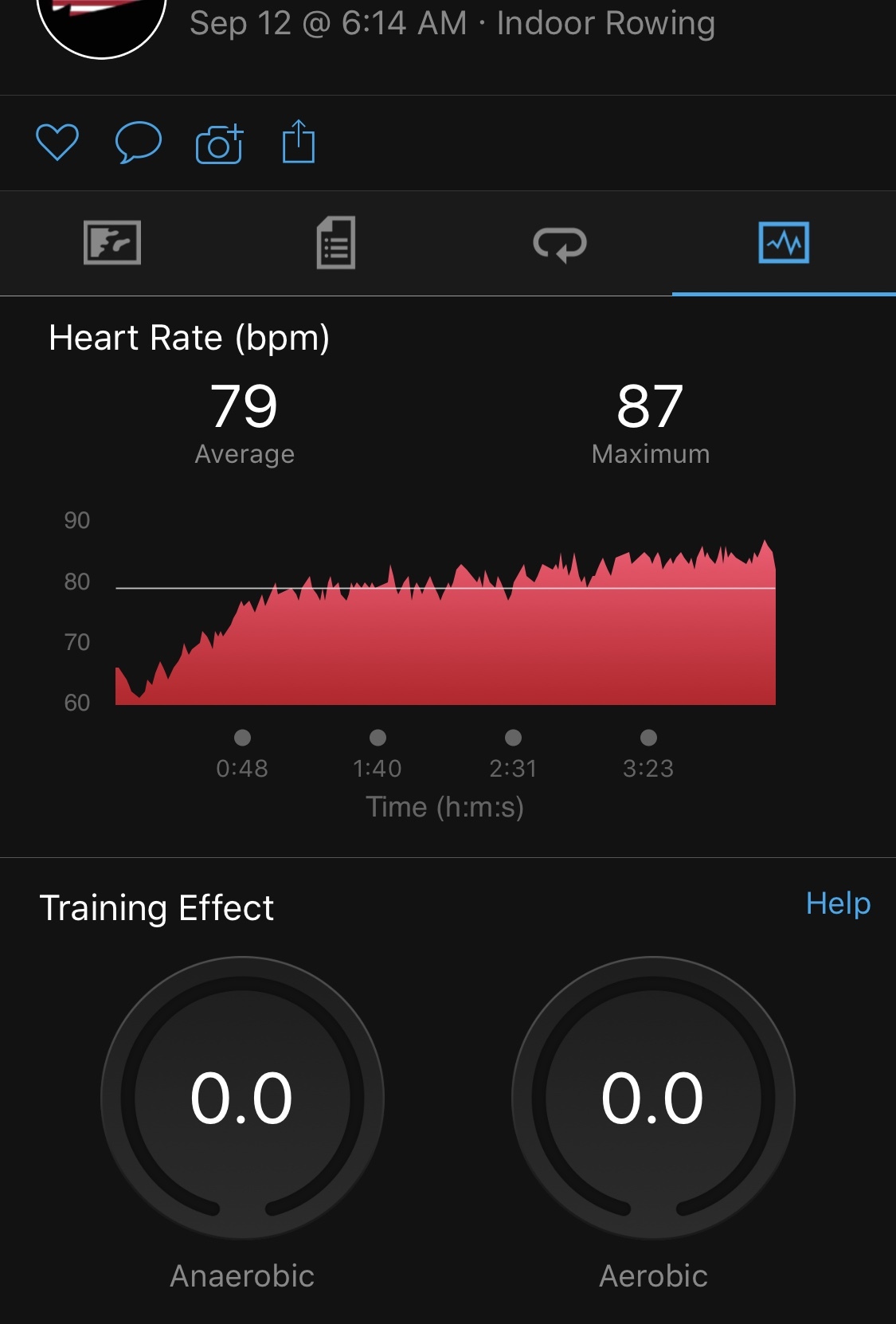

Upgraded to Fenix 5+ Titanium last week, running 4.20. Optical HRM seems to be working well for basic tracking, RHR, sleep, etc. However, when used in an activity, the measured heart rate seems to be stuck in the 70-90 bpm range. The watch is snug on my wrist. So far I’ve seen this behavior on both a rowing machine (ie, back-and-forth motion) and on a stationary bike. I’ll note that I am broadcasting to an iPhone and have had the same drop others have seen after ~2 min. I’ve attached 2 photos to illustrate:
1) 1000m warm-up row this morning, where HR gets stuck in low range
2) Similar 1000m row from 2 weeks ago using an HRM-RUN with Fenix 3
Following the warm-up row, I saw the same behavior during a 36 minute sandbag workout, so I switched from optical HRM to HRM-RUN at ~15 minutes, and the measured HR jumped from 80-100 bpm to 140-160 bpm.
