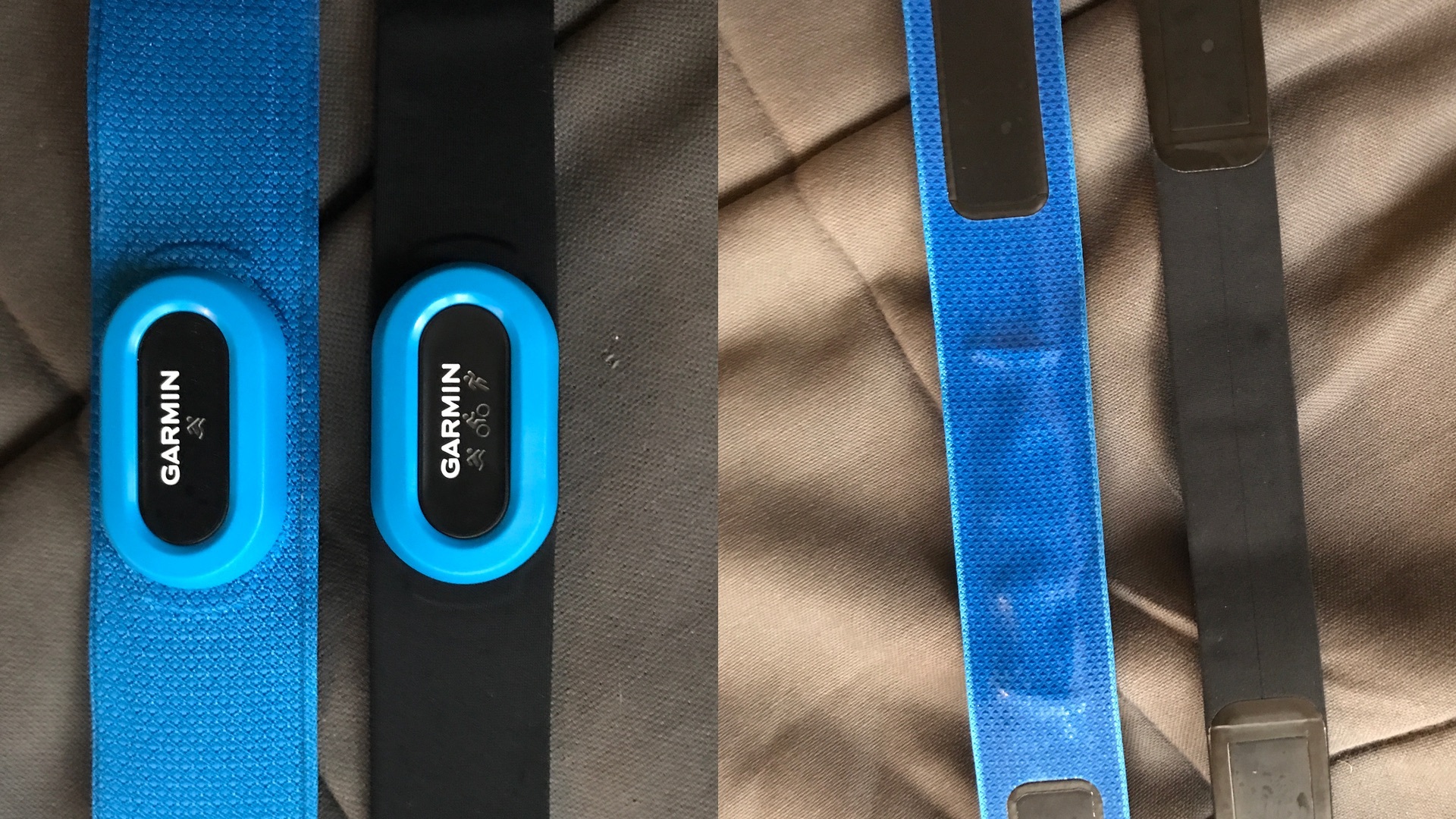

  • I have both the HRM-Tri and the HRM-Swim. You would not want to use the HRM-Swim for anything but pool swimming. To the point where I bought the HRM-Swim and ended up also buying the HRM-Tri. The material on the swim is excellent for not slipping in the pool, but I'd not want to go running or cycling with it. You always know when you are wearing it. On the other hand, the HRM-Tri is comfortable enough that I forget I'm wearing it - even after 7 hours in the saddle. Here are some photos to see the difference. You can see the super tacky backing on the blue HRM-Swim.ciq.forums.garmin.com/.../1401129.jpg
