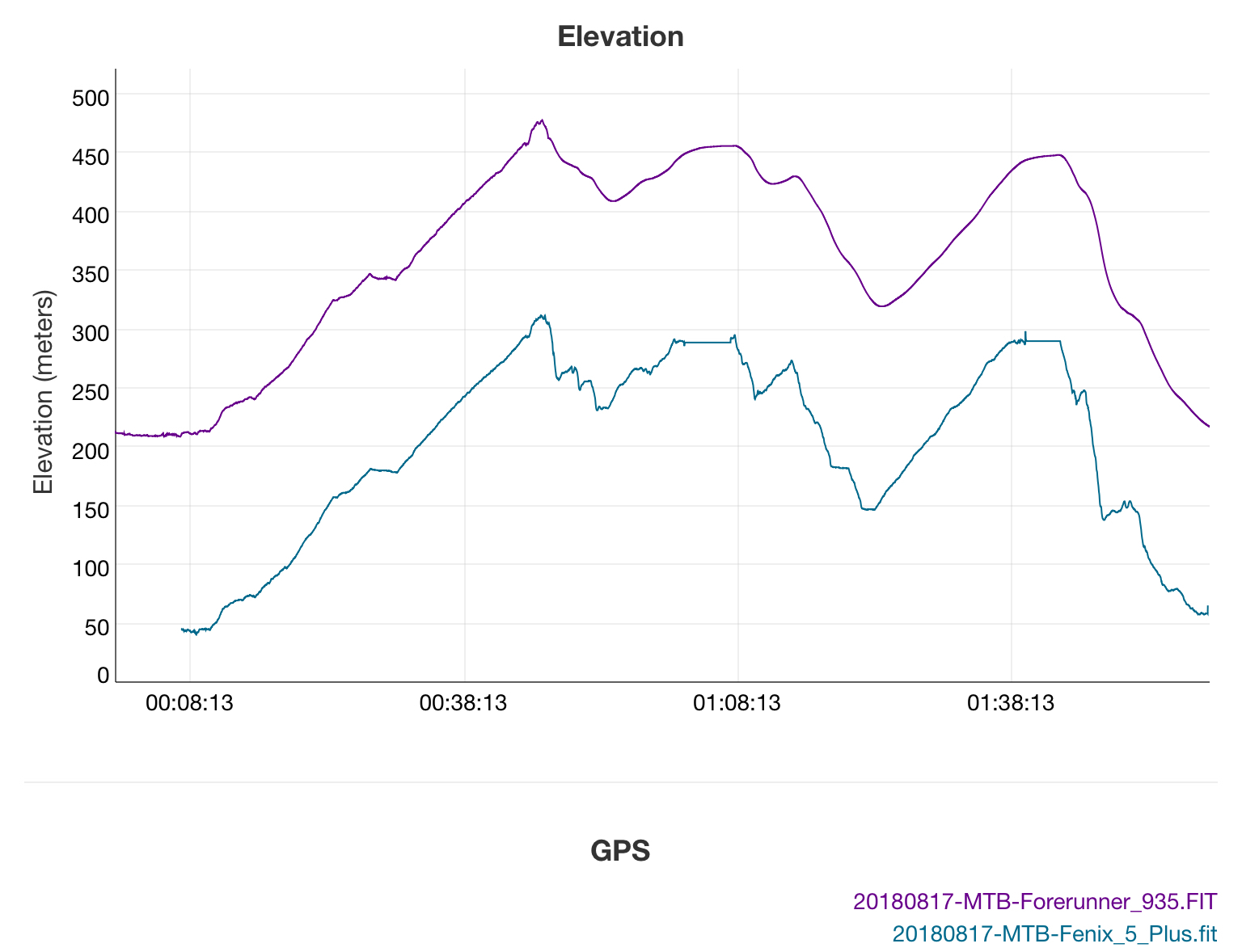

    Which software version were you on? Any production software on the Fenix 5+ series earlier than ver 4.20 contained the same elevation ‘over-smoothing’ bug that the Fenix 5 series and Forerunner 935 did until very recently (Fixed on Fenix 5 ver 10.00 and 935 ver 10.10). The easiest way to describe the bug is with a picture. The plot attached is a MTB ride I did with a friend last Friday (17 August); his watch was on the older 935 series sw 9.70 with the bug and my Fenix 5+ on sw 4.20 containing the bug fix. There is approximately 160m offset as the 935 was not calibrated at the start (my 5+ has the correct altitudes), but it’s the shape of the graph that’s important. My 5+ is picking up all the ups and downs in granular detail, whereas the 935 is considerably over-smoothing the ascent/descents and was also under reporting total ascent/descent. My 5+ used to have similarly over-smoothed elevation plots until one of the recent beta releases contained a fix (that is now in production 4.20). I can only imagine this over-smoothing bug is amplified to an even greater error with the rapid ascent to descent involved with sky diving. Whilst Garmin have replaced your hardware, it’s likely it is the software that was causing the issue.ciq.forums.garmin.com/.../1391997.jpg
  • Which software version were you on? ...... Whilst Garmin have replaced your hardware, it’s likely it is the software that was causing the issue.
