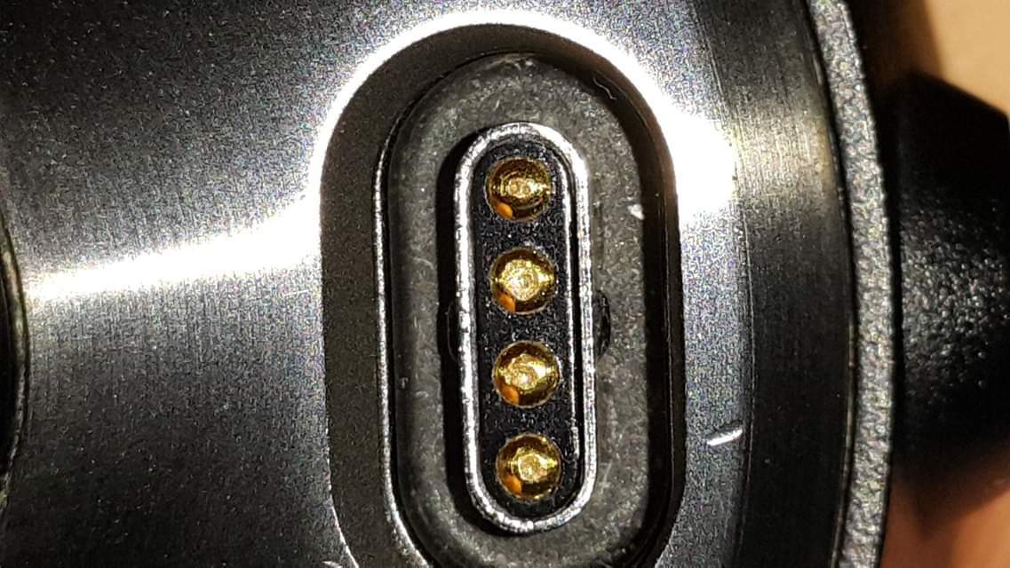

    This gold pins on the back of the watch for the charging and connecting it to the computer are indented. like gold is missing in the middle of the pin. And this is now lead to it having problem when I connect it to the computer it is not recognizing the USB device. So no way to connect it to Garmin express or base camp...
    I think this that this damage on the connecting pins is the reason whay device is not recognized. Can you guys check if yours are damage as well?
    This damage is being made by the charger it self...ciq.forums.garmin.com/.../1473188.jpg

    That also might be the problem but in my case it is not. I've tried on the multiple windows versions and computers and USB device is still not recognized...
