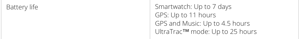

    With regards battery life, the 5S is officially quoted as having up to 11 hours in normal GPS mode https://buy.garmin.com/en-US/US/p/60...01987-00#specs ; so without switching to UltraTrac (which isn’t great for a pretty GPS track, but actually OK for some general navigation needs - do test first though, to check it does what you need) you are already getting as good as it gets for you 5s+ with the 10 hours you got. Unless you have purchased from somewhere that allows you to return and exchange for the 5+ (up to 18 hours) or 5X+ (up to 32 hours), the best thing to do is buy a small USB battery charging block thingy and just charge your 5s+ on the go (you will need to take the watch off your wrist, due to the cable attachment angle, but the activity can be left running/recording whilst charging)ciq.forums.garmin.com/.../1384990.jpg

    Crispin - Thanks for your help. I'm planning on a longish hike tomorrow so I'll be sure to calibrate the altimeter at the trailhead. And I've enabled UltraTrac so I will see if that will keep the watch running for longer. I don't really care about the watch's GPS track since I'll be running GaiaGPS on my iPhone.
