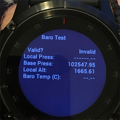

Let me begin by "thanking" Garmin Support Italy, for not replying at my email anymore. I've sent them an email, explaining the problems I have with my Fenix 5x Plus and they replied, telling me the procedure to reset my watch. Knowing it will not solve my problem, I did it anyway, worked fine for a couple of hours, but after that, SAME ISSUES! Mailed them again, letting them know that I did the FACTORY RESET exactly how they instructed me to do, but THE PROBLEM IS STILL THERE! Been over a week now, STILL NO REPLY!!!
I can understand that some products are faulty, but I cannot understand the lack of common sense from the Garmi Assistance Italy, after you,as a client, paid 750€ for a faulty product and YOU, as a client, have to wait for weeks for a reply from Garmin Assistance or not even a generic reply at least.
Left Fitbit for their faulty products and sh*tty costumer care, to end up in the same situation! I've been patient for a month now, having to calibrate altimeter almost every day, but enough is enough. I paid for a working product, not for a faulty one!!!

    According to Garmin Assistance in Italy, it's not broken. Sent it to them, they kept it for 23 days, only did a Factory Reset to it and sent it back to me with the same issues. After an hour of use had the same issue. In 2 weeks after receiving it back from assistance, had the same issue with ALTIMETER and BAROMETER 4 or 5 times. At least now, with the latest beta, I can calibrate it, because before, I couldn't even do that, I had to Factory Reset it every time.
