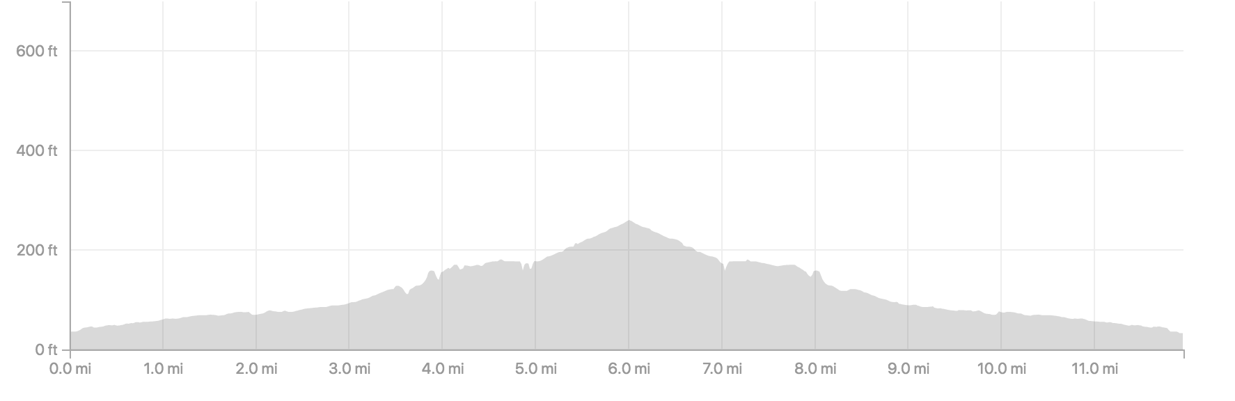

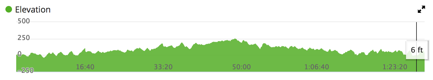

Just in case you have not performed a hard reset or checked the holes in front of the sensor for dirt yet.. it is worth a try. How do you calibrate? Manually enter the altitude, DEM or GPS? How is the altimeter indoors when you sit around, does that also show up and down drift every few minutes?
To me, this looks like GPS elevation data, rather than barometric elevation data.
So my guess would be that the watch saw an error in the barometric elevation signal and used fallback to GPS elevation.
Whenever you suspect that there are problems with the barometric altimeter, the first thing to check is the Ambient Pressure signal. This is the sensor signal, from which both Elevation and Barometric Pressure are calculated. You can enable Ambient Pressure as a datafield within an activity.
I have a suspicion that you will discover that Ambient Pressure shows no value or some insane values. I can't see any other reason that the watch should report an error when you try to calibrate the altimeter (assuming of course that you were not trying to calibrate from GPS in a spot where you could not get a GPS fix).
