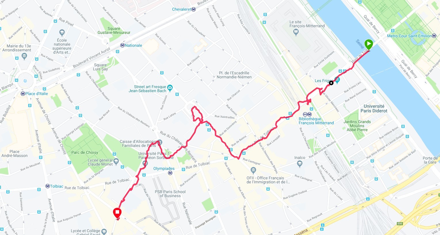

  • Here are some traces : On some part of the trace I am just in the opposite side of the GPS
    https://www.wikiloc.com/wikiloc/spatialArtifacts.do?event=setCurrentSpatialArtifact&id=26650280
    https://www.wikiloc.com/wikiloc/spatialArtifacts.do?event=setCurrentSpatialArtifact&id=26650169

  • Je ne pense pas que tu aies de problème, ce sont les "canyons" urbains qui bluffent la réception. :-)
    Been using GPS on my wrist since the first Casio in 2000: the city's canyon are playing with some "echoes".
    The worst places are Manhattan or La Defense with huge flat mirror building faces which can make your GPS going completely mad !!
    Essaye le "Lock On Road" quand tu es en ville.
    But in our hausmanian canyon Garmin should work on an algorythm using the speed and the bearing.
    Like a car's GPS actually to avoid "anomalies" in the tracks. When we run we are not using teleportation after all... ;-)
