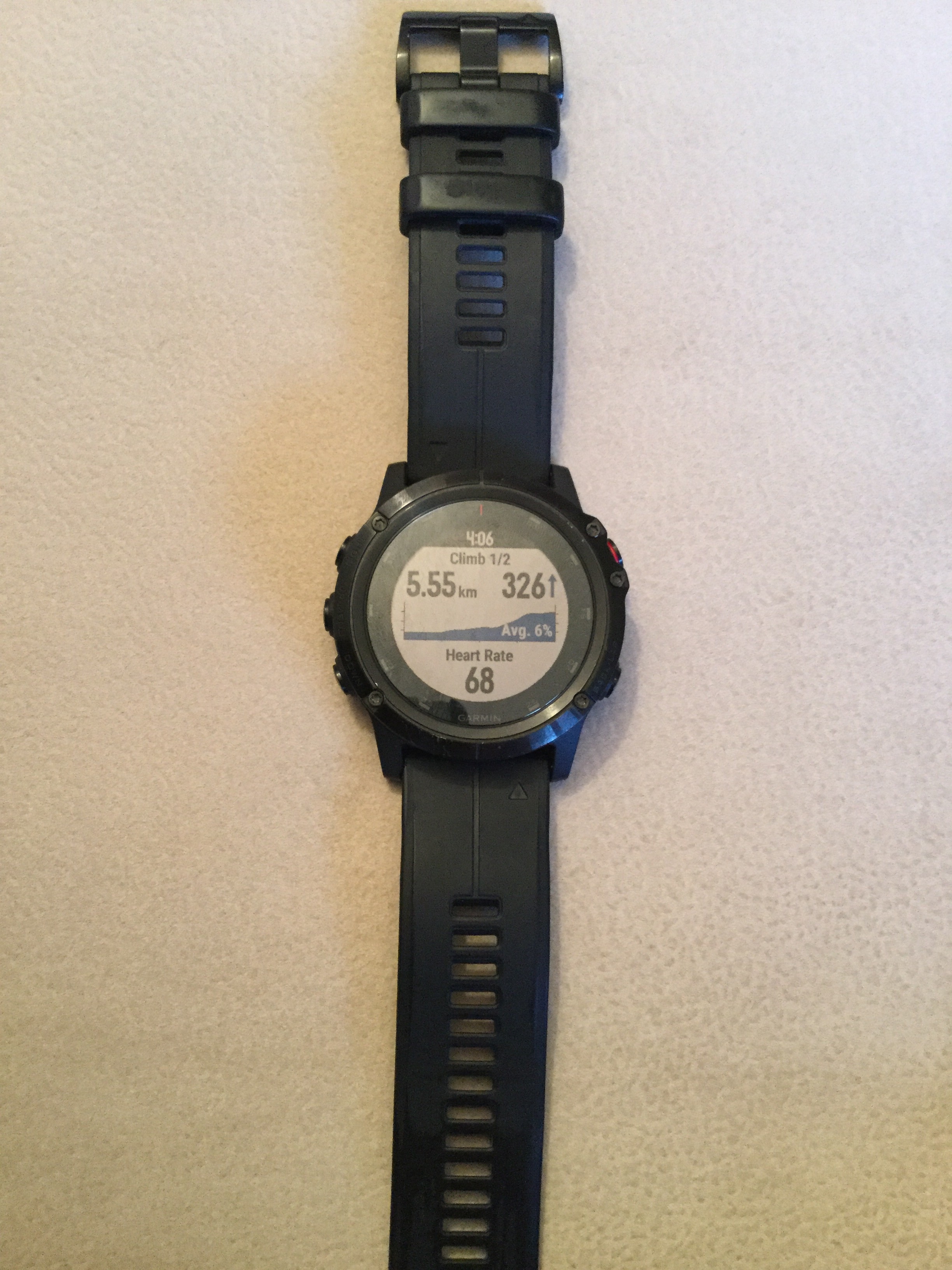

    I would like to be able to customise this screen a bit in terms of the data shown. (similar to the option for the Map overlay)
    Agreed. One thing I am curious about during longer climbs, even more than total time en route or vertical speed, is my HR. Unfortunately, I cannot get it on a ClimbPro screen. It would be nice to be able to customize this.
  • You already can use the hr data field for the climpPro feature.
