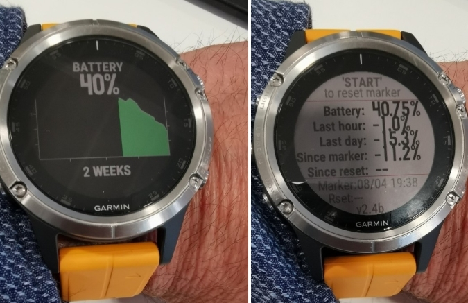

    I still think it is software related.
    Check the pic I attached.
    I charged the watch full on Saturday morning. Used in SM mode all the time. except for an 8 km run on Sunday afternoon and booted the watch right after.
    Now try to explain this power graph...
    BTW, I switched from Battery Widget to Battery Gauge
    I just inform my Garmin shop that if the next firmware doesn't improve the drain I want a new watch.ciq.forums.garmin.com/.../1471694.jpg
