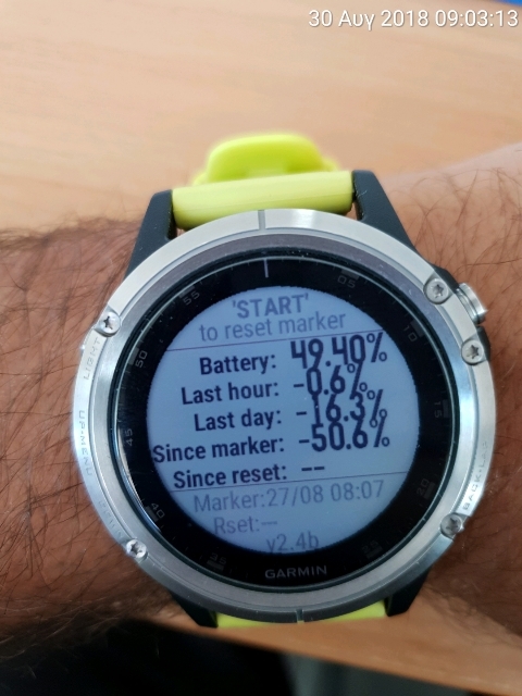

  • After 3 full days with 3 swimming pool activities at least 1 hour and 30 minutes each lost 50%..before full charging i pressed the light button for 15 sec..i am on 4.20 version with hr on,bt on and a lot of notifications every day..before i i press the light button the battery was lasting max 4 daysciq.forums.garmin.com/.../1396260.jpg
