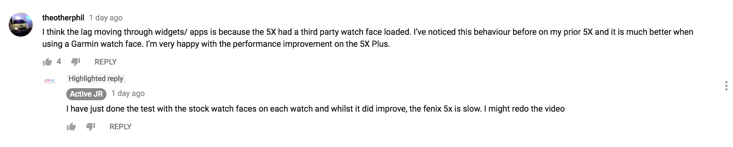

    It's noticeably faster. ActiveJR did a comparison on Youtube...
    www.youtube.com/watch
  • Just an observation, given that it is "known" that current firmware builds are suffering lag when using CIQ watchfaces, there is absolutely no point in making a video comparison claiming there is noticeable lag between the two when the plus version is running a Garmin built in watchface and the original 5x running a CIQ custom face. The plus clearly has a significant advantage for this reason.
    This test should have been undertaken with all watches running the same or similar Garmin watch faces, it's not rocket science, just common sense.
