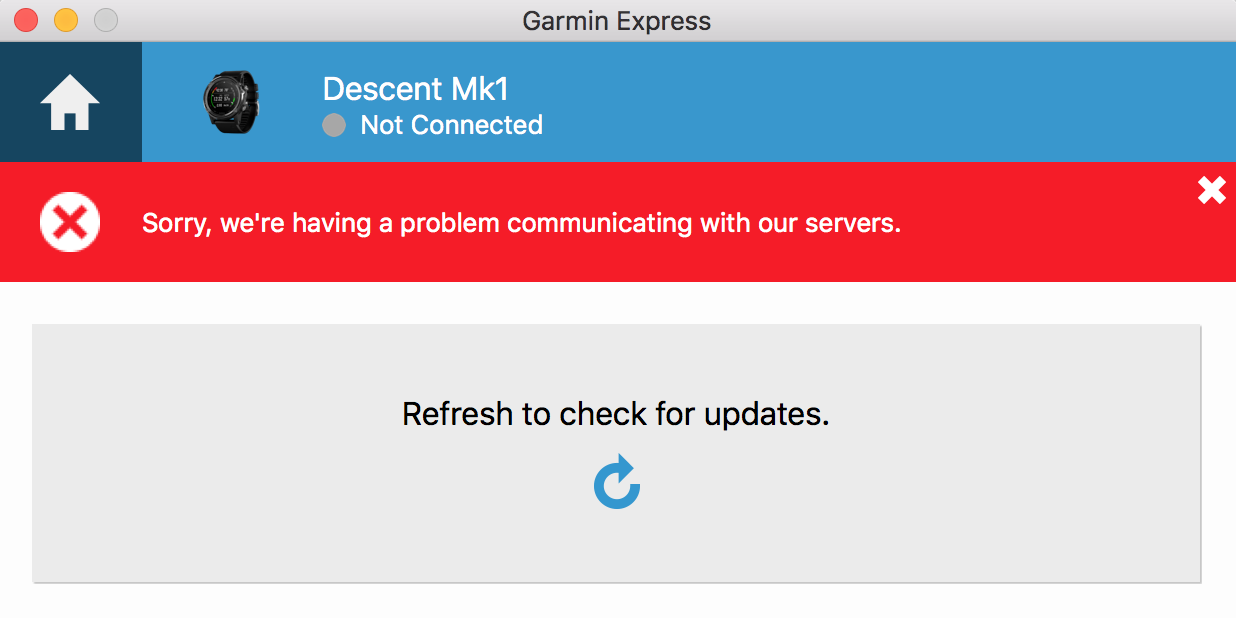

    I have the same problem, "Sorry, we're having a problem communicating with our servers." - I am unable to update via the mobile app (can't even figure out how to do this) - everything is synching just fine, and I've never had trouble with any of the previous updates. Running Garmin Express for mac 6.7.0.0. I have tried re-installing, restarting, a different internet connection etc etc... ciq.forums.garmin.com/.../1396013.png
  • I have the same problem, "Sorry, we're having a problem communicating with our servers." - I am unable to update via the mobile app (can't even figure out how to do this) - everything is synching just fine, and I've never had trouble with any of the previous updates. Running Garmin Express for mac 6.7.0.0. I have tried re-installing, restarting, a different internet connection etc etc...
    You wouldn't be based in Asia Pacific would you? Apparently, it is a region based problem that is being worked on at the moment.
  • Former Member
    0 Former Member over 6 years ago
    Sure am.... New Zealand.... Wish they would communicate that it's an issue somewhere, rather than a couple of the moderators in the Garmin express section being super aggressive about it being everyone else's fault....
  • Sure am.... New Zealand.... Wish they would communicate that it's an issue somewhere, rather than a couple of the moderators in the Garmin express section being super aggressive about it being everyone else's fault....
    I think they only just found out about it. I sent Heath a file from my Mk1 last night and he responded this morning that Garmin can now reproduce our problem.
    It's fairly typical of support organisations to blame the users until it is proven that it's a product fault. It shouldn't be that way but they all seem to operate like that.

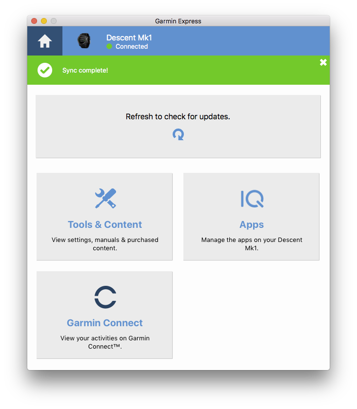

  • ARGGGGGH!
    Now, it's even worse. I can't sync at all. Neither with Garmin Connect Mobile or Garmin Express. Neither of them report any errors but no data is being synced.
  • ARGGGGGH!
    It appears that when support used the file from my Mk1 to test why I couldn't update my firmware, it broke the connection between my Mk1 and my Garmin account. My data was syncing somewhere else.
    I managed to fix it by removing the Mk1 from Garmin Connect Mobile and adding it back.
