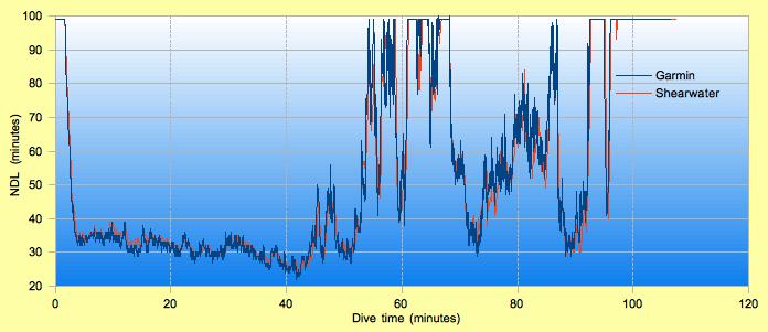

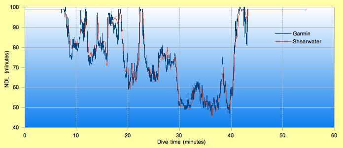

  • Why do you say the NDL is out? It has matched my Perdix on every dive - at least each time I have compared them.
    Here's a comparison from just one dive - I can do others. Note that the Descent was on my wrist and the Perdix on my camera rig so they weren't always at the same depth.
    ciq.forums.garmin.com/.../1336447.jpg
  • Damn! Garmin have changed the way the forum works since yesterday... ? They can't even run a half decent forum!
    I give up....
    Copy and paste the following URL to see the picture:
    http://atj.net.au/Dive2018031809The_Steps-NDL.jpg
  • Here's today's dive... again NDL between Descent and Perdix are very close (considering the Descent is on my left wrist and the Perdix is on the camera rig and I may be using my left hand to steady myself for photographs).
    http://atj.net.au/Dive20180041908The_Leap-NDL.jpg
  • atj777, I never said that NDL is out. I said that the Descent is not logging the dive time correctly and I was not sure if this would impact their NDL calculations for subsequent dives. I never compared the NDL on a second dive between my Descent and Perdix, planned on doing that today but tweaked my back so I did not go diving.
  • I did a double dive today. On both dives the NDL on the Descent tracked pretty well with the Perdix. I haven't downloaded the data yet but I expect much the same as I've seen on single dives.

    • NDL - Booth units display "—" whenever the NDL is over 90minutes (or so) and almost at the same point in the dive changed from "-" to display to a number of minutes
      Single Dives tank dives - the NDL's are very similar, with conservatism set to "low" the MK1 seems a bit more conservative, with "medium" setting a bit more tolerant
      Repeat Dives - the difference between the watches (or the algorithms?) was huge now, while the D6 was at an NDL of 7minutes the MK1 was still on 37min. This seems huge knowing my tissue was already highly saturated. Our dive guides watch was at 5 Minutes at this point of the dive, however it also was a Suunto (meaning also RGBM algorithm) as well. Suunto is known to have a very conservative algorithm so I am not saying the MK1 was wrong.
    • Erratic NDL display - especially on the repeat dive the NDL was very erratic, some few meters up or down caused a huge difference in the remaining NDL. So virtually every time I checked the NDL it was just somewhere between 37minutes and "-", this is not necessarily wrong, but definitely very confusing. On the D6 the NDL display is much more normalized what gave me more confidence.
    Standard behaviour of RGBM algorithm. Often gives you more time on the first dive but punishes you on subsequent dives. I recommend you read some of the many threads here: https://www.scubaboard.com/community/forums/computers-gauges-watches-and-analyzers.17/ that discuss differences in algorithms.
    Which is right? They are all just estimates and approximations of what happens as our bodies absorb nitrogen. As every person is different (different fitness levels, amount of fat, etc.) the algorithms are only just a guess. Even the rate of nitrogen absorption for a single person can change from day to day with many factors.
    If the D6 NDL display is "more normalized", I'd be wondering if it is perhaps rounding or not telling me the true story. While I have noticed both my Descent and Perdix showing wildly varying NDLs, on a normal dive I'm only checking the Perdix every few minutes and so wouldn't see this.
