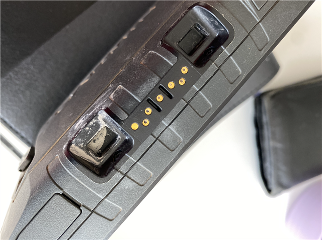

Had a 700i for about 7 months mounted on my adventure bike with the rugged mount and everything has been fine until yesterday when it started showing the ‘external power lost’ message and starting the countdown, but then the map will come back shortly afterwards. It was intermittent at first, but now it happens every few seconds and so in its current state, it’s unusable. My initial thoughts were a power supply issue as in a dodgy connection, but when the bike is stationery it’s fine but if I move the unit slightly in the cradle I can replicate the issue. Im thinking a pin connection fault ?
  • Someone on the Forum over at advrider.com said a similar problem was caused by the pins in the mount getting stuck (not spring loaded and retracting) and causing depressions in the contacts on the 700. Eventually it wouldn’t even work in another mount.
    if you set yours to Stay On when External Power is lost does it appear to work normally?
  • Yeah I’ve noticed mine has holes or depressions on the brass pins to. I did check the pins on the mount and they are indeed spring loaded. I’ve only just changed it to ‘stay on’ if power has been lost, but this is probably now irrelevant is the pins are buggered

    A few others chimed in with dimpled connectors on the 700i and complaints of a sticking release button on the rugged mount. One person said there were power drops until they used the locking screw, then it was solid. I checked my rugged mount pins and they look pretty and work fine. I’ve never used the locking screw on either of my 2 rugged mounts for the 700 series nor any of my 600 series mounts. Mine is mounted in Landscape orientation (pins on the bottom) and I can see some scoring of the 700i contacts under magnification which are elongated in what would be front to back wiggle/wear. All my mounts are attached to RAM handlebar mounts (ATV’s)

  • First thing I checked was the pins and if they were free to move as I thought they may have become stuck somehow, but they were quite easy to depress

    Right from the get go, I was treated as though this was a priority case, and they were determined to get to the bottom of the issue ASAP. Firstly I sent photos of my old unit with the damaged hot shoe pins, as in the above pics, and within a day I received a call from a claims officer who once again assured me the issue would be dealt with promptly as this sort of issue, not being very common, was of the utmost importance for them to make right.
