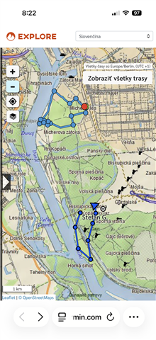

  • Hi. Currently, Garmin shows the route traveled on the map like this, the location update is every 10 minutes. The problem is not with the device, but with the topographic map used by the company. Just for comparison, I am attaching the route from the ZOLEO device where the location update is every 6 minutes.

  • I tried it according to the instructions from AI and it works. It shows the planned route and my current route.
