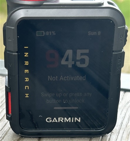

    Supplement: ok- just checked with a not activated M3+: if you try to send a message without activation; the device tells you" your device may not be activated...", so my thoughts above are not possible. The device is on sw 5.03, I put it outside with clear view to the sky now (81% battery; 9:45am).

    Btw: forgot mine outside yesterday. Will have a look at the battery in the afternoon (when I get back from the office).
  • Btw : at 6:03 pm at the next day, my M3+ is down from 81% to 30%. So I don’t know what was going on on your devices… (because it has gps connection).
