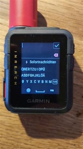

Normal layout:

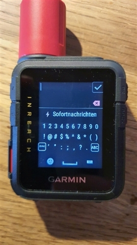

Switched to symbols:

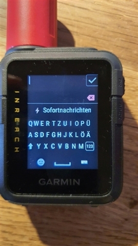

Back to letters (keyboard already getting smaller):

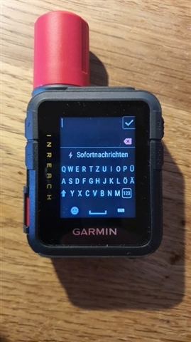

Switched to symbols and back a few more times (keyboard unuseable):
