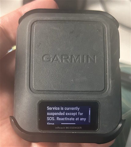

I last used my inReach Mini 2 with the "Enabled" plan back in March 2026. I set the plan to suspend at the end of that month, and the device was powered off.
Now, the Explore website shows my plan status as suspended, but the device still shows "inReach Enabled Plan | SOS included" in the plan details page.
When I tell it to update plan info, it just gets stuck showing "Waiting for response" even though I left it outside with a sky view for over 30 minutes. I even tried rebooting it outdoors again and it goes into the same state when I ask it to update plan details.
It is syncing with the Explore mobile app. It just performed the 5.04 firmware update earlier today.
I do not use the Messenger app and have no intention to (do not want this linkage to phone numbers etc.)  I have used it since day 1 with the Explore app and the Explore website where I enrolled the plan originally.
I also do not have a PC to run Garmin Express.
What I was hoping to find out was whether it would indicate "Suspended plan | SOS included" now as per the recent announcements. I am not sure if that is possible until the next time I resume service and suspend again though. I just don't understand why the device will not update to realize it is suspended...
