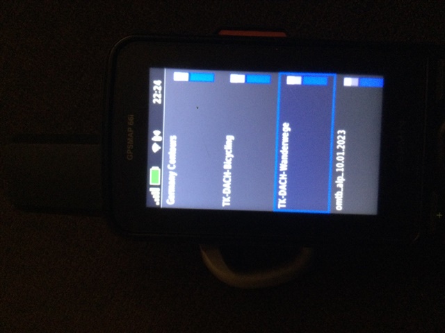

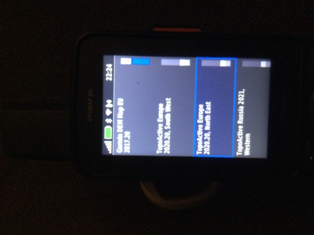

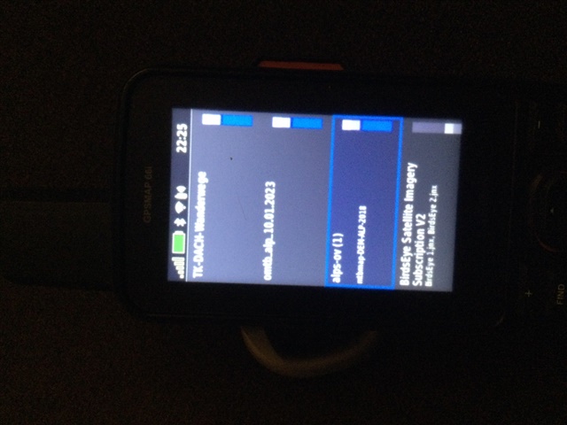

Attached pics from the map settings of my 66i

What I am not sure, 'switching off' , as in your pics , does really free the place for other other maps or they will be read in anyway, but just kind of inactive.
No.
All Map *.IMG files are indexed at boot. If the map segment limit is reached, the device stops indexing map data at that point.
When boot is completed, only the maps that have been indexed will appear in the map page setup list. Turning them on or off does not 'make more room' for other maps. It simply tells the device if they are to be displayed or not on the map page.
