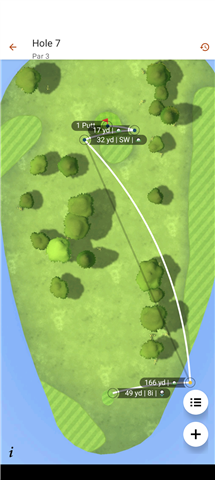

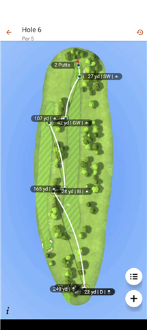

For the last 6 or so weeks the distances reported on some of the holes are way out some are 60-70 yards out. It's not on every hole but at least two per course I've played. It seems to be on every course I've played recently as well.

Also the shot tracking is all over the place.
The watch had become useless has I'm using to score everything as it can no longer be trusted. My friend uses a *** scope watch and his is 100% accurate and his was a fraction of the price.

  • Looking at the graphics of each hole exampled showing your concern, the shots you are seeing appear to be practice swings or other movements around the hole that are resulting in mishits being recorded.
    Practice swings are going to be one of the biggest reasons the shot locations shown in your pictures can occur and other movements similar enough to a swing where movement may result in the watch registering an unintended shot.
