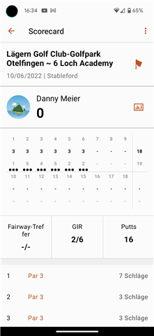

Example scorecard from today. The screenshots are taken with a course-handicap of 18 (54 for 18-hole divided by three). This example is for hole #1. In this very case, I had 6 strokes, but was automatically recorded as 7 stroke. For the other holes I had to edit and confirm after the last stroke. Btw, I'm using the CT10 on all of my clubs.
1) What's the meaning of 1 and three dots on the upper table? The table on the bottom shows 7 strokes. Not really sure anymore but I thought there should be 6.
2) In this case the 7 are equal, but for hole #3 it's on screenshot 1 3 strokes and here 4 strokes. What does the different numbers really mean? Garmin says this (https://support.garmin.com/de-CH/?faq=dPgjOFCiYm2B2i86npk6W7) but this is not any equivalent to my scorecard

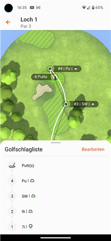

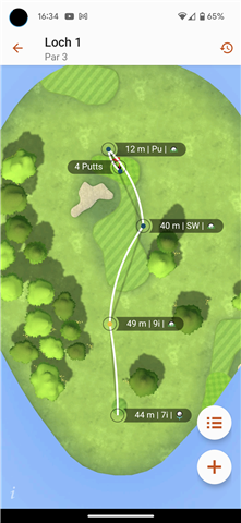

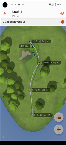

3) Show 8 strokes (three with irons, one with putter and additional four puts). What are the blue dots indicating?
5) Other arrangement of strokes (all clubs have a CT10 sensor)

    From Your scorecard You see You have 3 shots on all holes, represented by the 3 black dots.
    On a par 3 hole, with 3 extra shots, Your par is 6. 6 strokes will give You 2 stableford points as this is Your par. If You do 5 strokes You will get 3 stableford points, and 7 strokes gives You 1. The line Danny Meier is Your Stableford points for each hole, total 19. Par on 6 holes is 12, so You've played way better than Your handicap. In fact 21 better (7x3), so You played to approx 33 in handicap. I'm not totally sure how this works since You only played 6 holes, and don't have more than 2 extra shots on round 3, but not important here.
    On hole one You have registered 7 shots. 2 irons, 1 putter outside green, and 4 puts on the green. Not sure how the ct10 works, but I guess You have to enter number of puts on green only (3?) as it will register Your shot outside green automatically.
    Strokes are normally total number of strokes from tee to hole. Penalties may ruin this. If You hit Your tee shot out of bounds, You will have to do another. This will be Your 3'rd stroke, but watch doesen't necessarily know that. So You may end up with 3 strokes on the graphics, when You actually made 5. So You need to tell the watch how many strokes in total, and I also get asked about penalties. You need to turn on statistics in order to be asked for this I believe, but may be a different way when using ct10.
