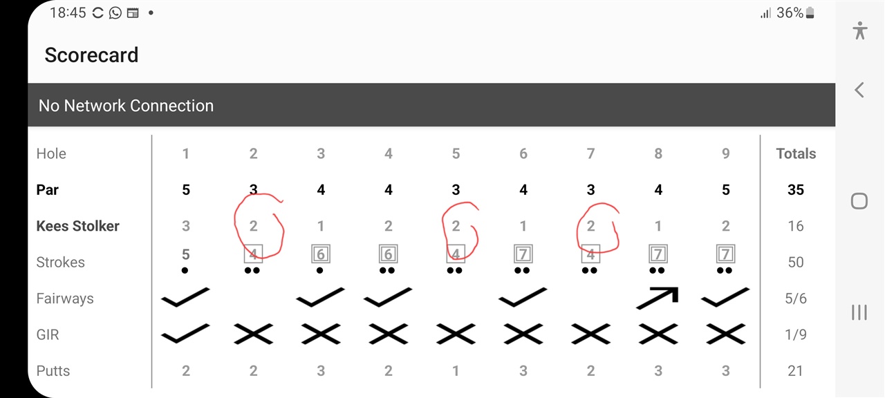

My problem is not so much that the dots are on the wrong holes, but that the total number of dots is incorrect. So the total number of stableford points will be under estimated at the end of my round. When I later update the playing handicap of the scorecard in the Garmin Golf app, the points are calculated correctly. Most of the time, because yesterday, I also ran into an issue that the stableford points are calculated incorrectly. See the attached scorecard...
Sounds like the Garmin course definition is wrong then so I suggest sending a copy of the scorecard and various hole ratings off to Garmin. My home course has just completed and official Golf Canada rerating, so I will be doing the same and submitting our official scorecard off to Garmin. No idea how long it takes Garmin to make and release updates though
