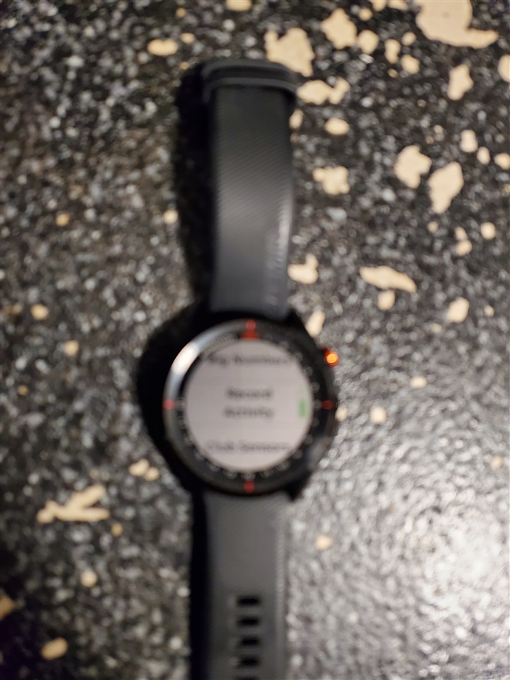

  • Are Golf Settings->Record Activity enabled and Watch Settings ->Activity Tracking both enabled.  Seems like some of the OOB default settings may not let things work they way we think they should.
