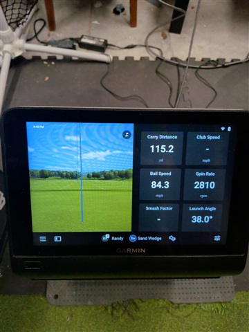

    • Screenshots or photos of several wedge shots showing the spin readings.

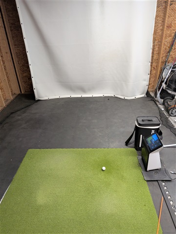

    • A photo of your R50 setup from the hitting area.

  • Tried all the trouble shooting. I get the right spin numbers down to even pitching wedge then as soon as soon as I bring out my GW,SW,LW it starts getting the spin ratings seen in the picture below. I have also included a picture of my set up below.
