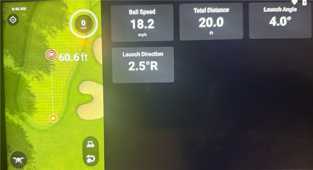

    I'll also note that the readout on the Garmin for Total Distance doesn't seem to work at all when I'm putting. I hit a putt that rolled exactly 60' on Bethpage #3. Ball Speed = 18.2, Total Distance = 20.0 feet. Not sure if that's related or a separate issue.
