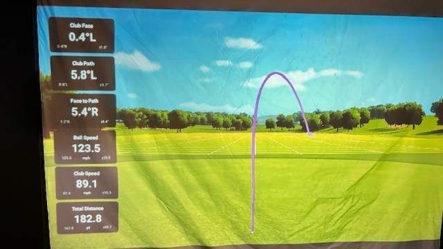

I am struggling to understand that why R50 software wrongly calculates the ball flight.
Two big problems:
1. Their algorithm calculates almost everything going Right. Attached picture below:
I had 5.8L Path and 0.5L Face, in every golf book this ball is supposed to draw or hook. Even a generative AI also says hook or draw but Garmin R50 shows Fade/Slice
2. Anything not set to 10000 elevation the distance from every club is 25~30% lower.
I tried these outdoors and same miscalculations. Can anyone suggest if you similar issues and were you able to fix.
  • Face to Path is open to the right. This creates cut spin. Club is traveling left with open face to path. Distance killer!
    Work on club path going 3 or so degrees right and face to path less than your club path. Even if you have to do little 50 yard shots with a closed face. Just make sure it reads club path right and face to path less. The ball metric should show left spin.
    Look up golf ball metrics for face to path.
