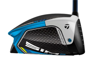

Absolutely love this unit but only "complaint" or head scratcher (if you wish to even call it that) is with the driver. I do not believe any of this is indoor swing syndrome at all as I formerly had a doppler based unit I hit indoors and it was always pretty much same indoors as outdoors. I am getting a very mixed bag of shots from shape, height, speed, and data readings with my driver (Taylor Made Sim2) in comparison to my friends who have say Titleist drivers or insert other brand who doesn't have the graphite carbon back of head or multiple colors with the silver and blue in it. When hitting their drivers those problems seem to disappear for me and data and shot shows what I would expect.
Long winded way to ask if my theory holds any water, that as an optical based LM, if it perhaps struggles picking up exclusively the reflective marker for certain head styles/builds that could also be reflective? I have found that even when I take sticker off and have it on club/ball data setting that it often will still give me club data with my driver and why I am thinking there is something to it. After messing around with this last night, I found it to be much more consistent for me when I turned off club/ball data and moved it to ball only.

  •  Picture added to provide some illustration of what unit would be seeing.
  • Id suggest swinging the sim2 five times and then putting black electrical tape over the toe end of the markings and swinging it 5 more times and see what the results say.

  • Appreciate that Cody and perhaps that has something to do with some of the driver reading issues, but still hopeful to know from Garmin if design of driver heads can hinder club data readings? I have not taped my club as another person suggested but have continued to hit with ball data only setting and that seems to solve the problem for flight and ball data I would expect based off the swing and strike. This issue only occurs for me exclusively with driver with ball and club data setting.
  • Ensure the location of the single sticker is adhered to the top middle section of the club face on the driver, and make sure the sticker is still highly reflective on the surface...not worn looking or discolored.
    Other than that, if there is a concern with a metric error occurring...check the metrics provided on the unit after a shot with an error to make sure the face of the club allowed capture and that the larger shape and size of the driver did not prevent the camera from seeing the sticker due to the angle of the face at impact with the ball.
    There is not any specific type of brand driver or color combo that we have noted as working less better with the capture of the shot from the Approach R50.
