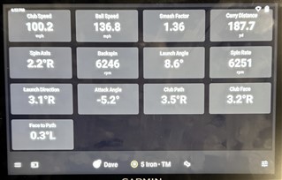

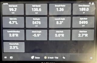

    9 iron data

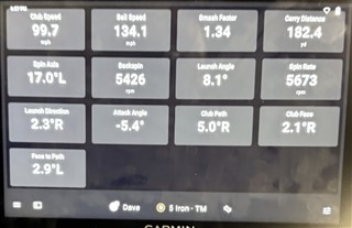

    5 iron data
    So as you can see here MY Garmin R50 seems to be showing much lower ball speed figures with 9 iron and starts to come into line a little more when hitting the 5 iron.. which equates to lower smash numbers.. much lower in the 9 iron which were my findings with my PW
    This equates to quite a clear difference in carry numbers on both clubs
    Also Garmin is showing a bit more spin and i wouldn't want to argue either way if it was Trackman or Garmin that is correct here and also a slightly higher Angle of Attack on the Garmin
    Toptracer is showing both ball speed and carry distances in line with Trackman though and i can tell you watching him hit the ball the toptracer distance was more accurate than the Garmin R50

  • Without a doubt big discrepancies here. This person is not hitting a 5 iron at -5.5 AOA.
    Take it to the retailer and see what they say once a few people hit shots with your unit.
