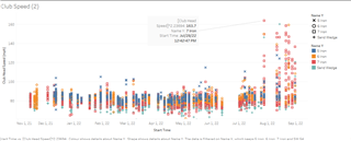

I have data to back up some suspicion about club head speed acquisition since V4.20 (end of July release) or at least I believe it is 4.20. It is the one where the change was specifically to "improve" club head speed detection. First of all it is extremely annoying that there is no longer any record of this firmware version release anywhere on the web but I'd rather not waste time on this and just go ahead to show my data.
This is approx 3700 shots of my three of my most used clubs while using the R10 over the last year. You can see a sudden increase in number of bogus club speed readings starting on Jul 28, which I believe should coincide with the 4.20 release.
If you are reading this and have also recalled getting insane club speed readings starting Late July-Early August, you are also experiencing the same issue and I invite you to share your experience and data if possible so this can be fed back to the developers. Something they did to the algorithm seriously made things worse.
