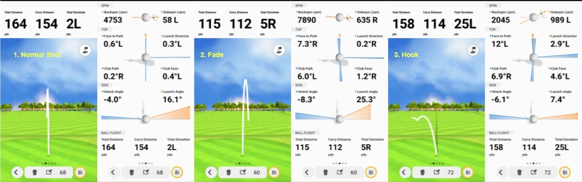

  • Club path, face and shot shape are similar to my normal shots(1), A bad shot for me is usually a push or pull depending on my club face angle and rarely draw or fade.  I have a really hard time fading/slicing the ball(2) but managed to produce on R10.  I feel I can easily hit a draw or hook intentionally but did find it hard to produce that shot shape (3). Could be that I am finding it hard to hit it inside to out thinking i am going to hit into the wall.  I am going to go to a trackman simulator next week and will record my stats and report here to compare to R10.  Overall I am very impressed by the results. I can always tell when I hit a push or pull at impact and the R10 always picks it up correctly.  I do see some weird shots and when I look at the stats I see it missed a bunch of data placing a dash (-) instead of a value.  Or unless that is how it measures exactly zero but I think not.
