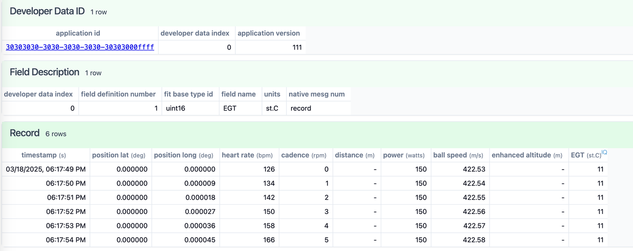

Hi,
For the last two months, I have been trying to add a developer field to the record message (like in the example with doughnuts earned) in C, but I am still doing something wrong.
My custom field is EGT in °C.
Please help.

//FIT_MESG_DEVELOPER_DATA_ID
FIT_UINT8 local_mesg_number = 1;
FIT_DEVELOPER_DATA_ID_MESG developer_id_mesg;
Fit_InitMesg(fit_mesg_defs[FIT_MESG_DEVELOPER_DATA_ID], &developer_id_mesg);
snprintf(developer_id_mesg.application_id,16,"0000000000000");
developer_id_mesg.developer_data_index = 10;
developer_id_mesg.application_version=111;
WriteMessageDefinition(local_mesg_number, fit_mesg_defs[FIT_MESG_DEVELOPER_DATA_ID], FIT_DEVELOPER_DATA_ID_MESG_DEF_SIZE, fp);
WriteMessage(local_mesg_number, &developer_id_mesg, FIT_DEVELOPER_DATA_ID_MESG_SIZE, fp);
WriteMessageDefinition(2,fit_mesg_defs[FIT_MESG_FIELD_DESCRIPTION],FIT_FIELD_DESCRIPTION_MESG_DEF_SIZE,fp);
FIT_FIELD_DESCRIPTION_MESG wlasne_pole;
wlasne_pole.developer_data_index = 0;
wlasne_pole.field_definition_number = 1;
wlasne_pole.fit_base_type_id = FIT_BASE_TYPE_UINT16;
wlasne_pole.fit_base_unit_id = FIT_FIT_BASE_UNIT_OTHER;
wlasne_pole.native_mesg_num = 0;
wlasne_pole.offset = 0;
sprintf(wlasne_pole.field_name,"EGT");
sprintf(wlasne_pole.units,"st.C");
WriteMessage(2,&wlasne_pole,FIT_FIELD_DESCRIPTION_MESG_SIZE,fp);
FIT_UINT8 local_mesg_number = 5;
FIT_DEV_FIELD_DEF devx;
devx.def_num=1;
devx.size = 1;
devx.dev_index=0;
WriteMessageDefinitionWithDevFields(local_mesg_number,fit_mesg_defs[FIT_MESG_RECORD], FIT_RECORD_MESG_DEF_SIZE,1,&devx,fp);

static uint16_t cht=0x0B;
//cht++;
WriteDeveloperField(&cht,sizeof(cht),fp);
