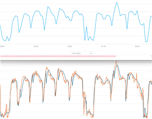

I am looking to extract speed values from a FIT file with 1 second recording turned on, and noticed there is both record speed and GPS Metadataspeed.
The record speed looks erratic, and is constantly overshooting and undershooting by 2 kmhr evern 2 seconds the GPS Metadata readout, which looks like a more realistic ( or possibly smoothed, I'm not sure ) speed trace.
Speed was recorded on the water with 100% view of sky.
Can anyone confirm properties of either? Here is a sample of the two plots, with GPS MEtadata the stable readout, and the erratic readout is the Record, which I suspect has altitude or accelerometer input by the looks of it?
0.937 | 0.917 | 0.822 | 0.787 | 0.861 | 0.896 | 0.964 | 0.985 | 0.984 | 1.002 | 1.014 | 0.939 | 0.958 | 1.013 | 1.033 | 1.054 | 1.048 | 1.075 | 1.128 | 1.169 | 1.149 | 1.157 | 1.135 | 1.107 | 1.047 | 1.003 | 0.984 | 0.908 | 0.848 | 0.796 | 0.802 | 0.806 | 0.788 | 0.731 | 0.715 | 0.715 | 0.674 | 0.668 | 0.668 | 0.626 | 0.607 | 0.571 | 0.576 | 0.656 | 0.747 |
0.448 | 0.793 | 1.801 | 1.521 | 0.634 | 1.222 | 1.092 | 1.073 | 1.344 | 1.148 | 0.485 | 0.821 | 0.924 | 0.746 | 1.437 | 1.465 | 0.998 | 1.073 | 0.98 | 1.25 | 0.998 | 1.344 | 0.942 | 0.644 | 1.073 | 1.222 | 0.532 | 0.532 | 1.288 | 0.606 | 0.849 | 0.905 | 1.316 | 0.718 | 0.42 | 0.69 | 0.84 | 0.914 | 0.317 | 0.569 | 0.69 | 0.728 | 0.476 | 1.148 | 1.166 |
