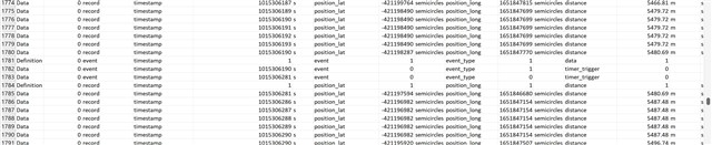

In the attached image you can see on line 1781 where the pause, and then resume occurs.

    it's just the Split breakdown is including the pause duration, not distance. It's like the upload platform is not recognizing the timer events.
    see comparison image ,left is the same activity recorded on a Garmin, right it my generated fit file from my app.
    the fit file from my app is also there, plus the fit->csv output.
    Hopefully you can see something I can't.
