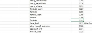

    Thanks, FIT_GARMIN_PRODUCT looks to be what I'm after. Is there an easy way to translate from that value to something resembling a product name for showing in an app?
  • This is what the Profile.xlsx in the SDK says. But, for me 3291 only tells me that its a Fenix 6X. It doesnt tell me that my device actually is a Fenix 6X Pro Solar Titanium. Ben FIT, do you know how I can find the additional information of the device?
  • The Garmin product ids in the FIT file provides the model. There is nothing in the FIT file that identifies the finishes.
