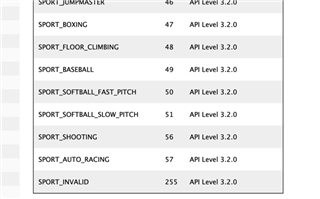

I am looking for the following codes for sport and subsport types. Can you provide information on that?
sport=54, subSport=61
sport=52, subSport=generic

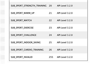

I was unable to find it in the current FIT SDK within the profile Spreadsheed
Honestly nobody? I also looked into the ConnectIQ SDK....nothing. How is that possible?
