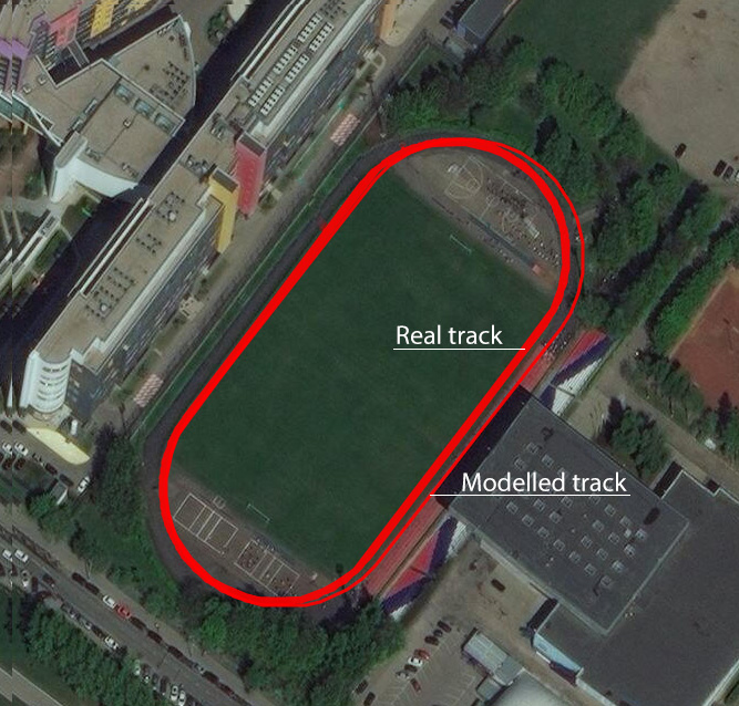

Is there any information on message format for track run mode track description fit file (ones from RunningTrack folder on 945, Fenix etc)? Current SDK is silent about it.
Looks like Garmin approximate track with two strait lines and two semi-ellipses and the message contains:
  • track center latitude (semicircles)
  • track center longitude (semicircles)
  • first semi-axis (aka half the distance between strait lines, cm) track altitude
  • second semi-axis (cm)
  • strait line length (cm)
  • orientation angle (deg)
  • 0 - ?
  • 1 - ?
But it seems that the model is incomplete (as you can see, the lines are not identical), so I definitely missed something.  Any suggestions?

  • EDIT: Sorry I can't read... You've already mentioned what I posted below. :) Anyway, the original fit-file may still help. So we want the formula for what's presumably track/ellipsoid parameters derived from it's center coordinate?
    EDIT2: Are the differences due to something as boring as GPS inaccuracy on top of the "perfect circle" model, perhaps?
    It's somewhat easier to dissect if you post the original fit-file, not the csv-result. Is that possible? Line 7 may contain a coordinate in semicircles, which somewhat fits with a location in Moscow if one of the 3000-ish values on the same line correspond to altitude (roughly 200m above sea level).
  • Yep, line 7 contain latitude and longitude of the point in the middle of the track :) Can't collect information on other tracks now -- it's winter in Moscow, so running tracks are covered with snow and ice :)
    Interesting idea about altitude, this track placed between 200 and 210 m, closer to 200.

  • one of the 3000-ish values on the same line correspond to altitude
    First one.
  • Here another fit file for another track. 3285 definitely means altitude - 157 m. Next value -- 104 -- is same in both files.
    Result is available here. Sorry for pace, at least ankle-height snow there :)
