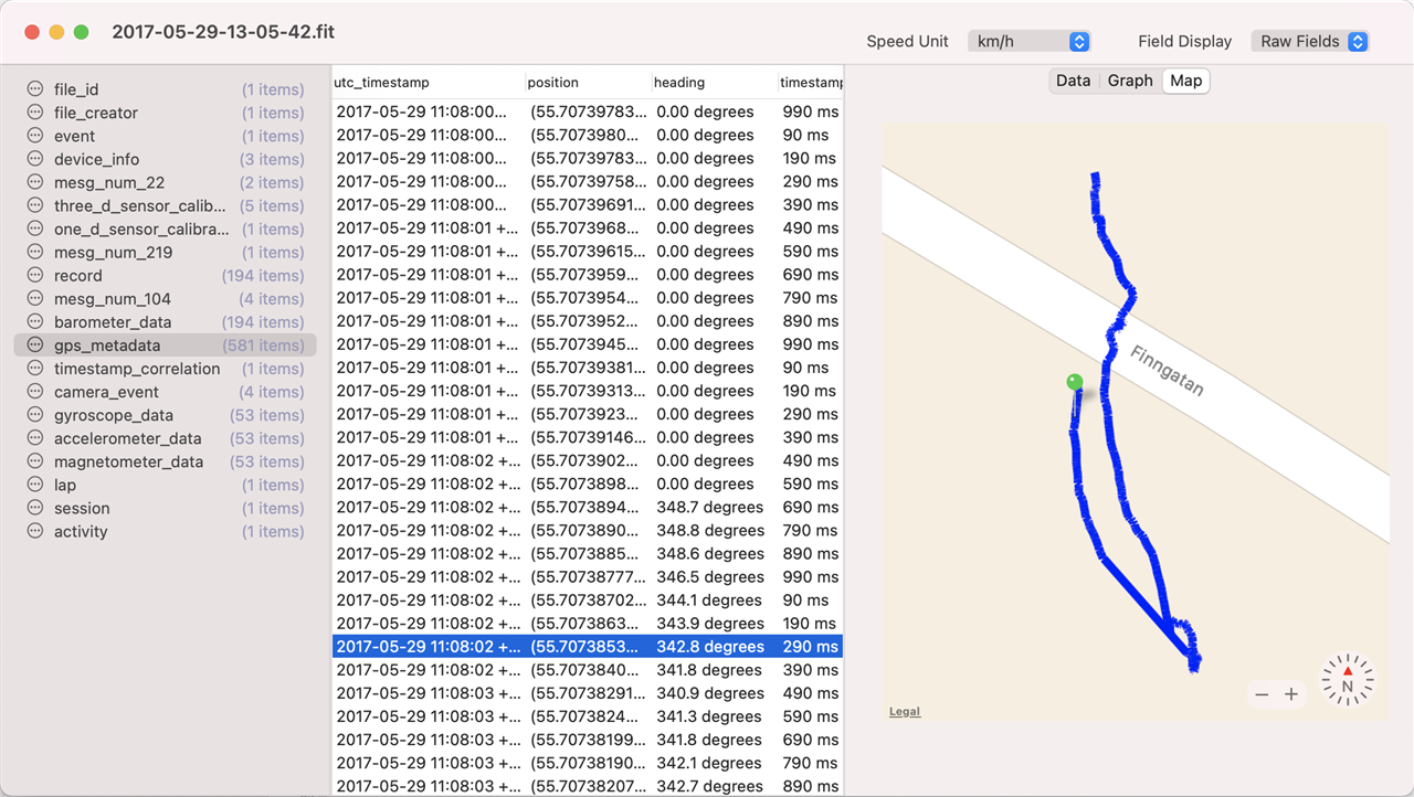

  • I need to get my mac vmware emulator running again just to check out your tools, looks fantastic.

  • That's great - I recognise the street. :)
