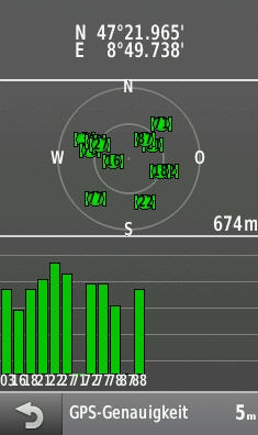

  • New Beta Feature: Galileo satellites. There is now support to use the Galileo network of satellites to assist in getting GPS fixes. With the correct GPS firmware, this option can be enabled by selecting GPS+Galileo in the GPS setting. Sync the device with Garmin Express to make sure that the new line of GPS firmware is provided to the device. Without this, the option will not be available.
