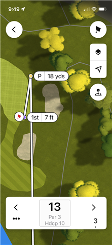

2.  When you enter correct number of putts on the watch and/or the scorecard they sync with each other but the shot maps do not update to the correct # of putts.  It seems this would make most of the stats wrong.

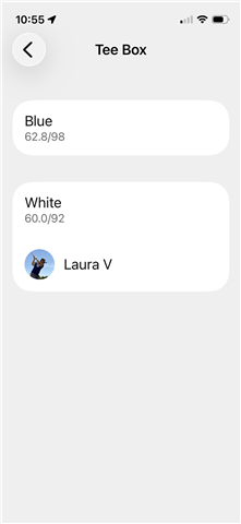

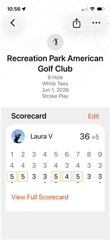

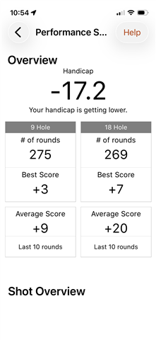

3.  There has always been a modest discrepancy (1-3 strokes) between my GHIN index and Garmin's estimate (I suspect because Garmin uses men's course ratings regardless of user's gender, as I previously reported), but now it is off by about 25 strokes.  I suspect (as I previously reported as a course error) that Garmin is using an 18-hole rating for a 9-hole course I play regularly so it thinks I am playing 30 under par (nice!).  My GHIN is 14 but Garmin thinks I am a +10.  Interestingly now that it thinks I am better than a pro golfer, my shots gained results vs my new peers (pros!) has also dramatically improved! Nice!!  But useless.

  • Re 1&2, it looks like before the app update to show  locations of specific putts, the shot map would just show total putts and would sync that number with the scorecard. Now you have to manually edit the shot map to add/remove putts to get correct # and guess about location(s).  The accuracy around the green is off by at least 10-20 feet -- prob same as before and maybe as good as poss with GPS but still makes putting stats by distance useless (or just more apparent how useless they always were).  Attaching screenshot Hole 13 -- I set the pin location on my watch based on laser distance from tee box. The shot map does match my watch, but pin was at least 10 feet closer to center.  The first putt showing as fringe putt was actually on the green and at most a 18 foot putt, not 18 yards.
    Re 3, attaching 9 hole scorecard, 18 hole course rating and my -17 handicap (=+17 index).

  • Re the putt locations, it happens on all courses.  I've figured out how to edit the shot maps manually to reflect the correct # of putts and move putting strokes on or off green as necessary.  A pain and imprecise but at least GIR stat is correct.
    Re the handicap, excluding the 9H rounds from stats in the round settings does bring the handicap back to within 1 stroke of GHIN, confirming my suspicion that this is the issue. Not really a solution though as I don't want those rounds excluded from all the other playing stats.
