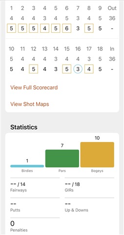

I‘m using the S42 and recently added 3 CT10 sensors. For my last rounds now no stats are showing for the round, even though it is activated on the watch. Not even puts or the strokes are added.
What can be done?

For me, when I look at the detailed scorecard, all the data is captured, it‘s just not showing. Did you also recently add the CT10‘s or is it an app issur?

I don't know if I can override this. But on the round, sometimes it doesn't ask for manual stats, sometimes it does. I think it asks for it, when the score I enter is not corresponding to what Garmin thinks.
But the weird thing is, that the data is in the scorecard. I can manually check them, so I think I'll stick to it for now, hoping Garmin fixes this. Because I got the CT10's to get more insights on putting and chipping.

Delete the Garmin golf app and reinstall!
it worked for me, and all my previous round were corrected too.
Thanks for the tip. This has indeed fixed the problem
Just did that. Has worked so far. Will play tomorrow so will see if it keeps behaving and uploading!! thanks for the advice
