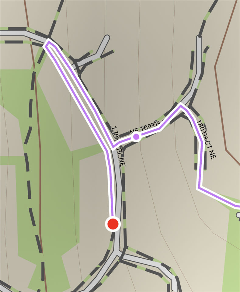

  • I have just tried creating a course using Garmin Explore and think it needs more work. The main issue is that it cannot cross a neighborhood street. It seems to have all the sidewalks separate from streets, and when I try to e. g. make a turn into a side street, it can't just cross a street and go where I need. Instead it makes an arbitrarily long out-and-back to a nearest intersection where it can cross a street, then returns back on another side of the street, and finally goes where I need. Considering that I am talking about narrow neighborhood streets with no traffic, that is simply ridiculous. I assume it would probably work better for a course that is 100% on trails, but every single other course editor that I tried before handles the situation described above correctly.

  • In my case it explicitly shows sidewalks as separate trails. It doesn't show sidewalks on all streets though - I guess that depends on the underlying map data. Some streets show sidewalks and some don't. In those cases when sidewalks are present, routing is completely messed up as Explore treats those as separate paths and can't jump from a sidewalk to a street.
    I should add that Garmin Connect mobile (on Android) has exactly the same issue. It doesn't show sidewalks but routes in the same ridiculous way.
    Here is an example:

  • Pedestrians are definitely allowed everywhere. These are typical small neighborhood streets. There are no crosswalks and hardly any traffic, and people cross them at will. If you look at the example I linked above, it goes to a nearby trail crossing a street, but let me assure you that that crossing is no different than crossing a street in any other place.

  • I only saw your screenshot after i sent my reply. Strange that the sidewalks are mapped as individual paths. I think this is not standard. So i also agree on your conclusion, that it is caused by the underlying map material. As a workaround, have you tried to start your course on the street instead of the sidewalks? Then it should route you along the street i guess.
  • Yes, starting on a street works. But that requires a great precision tapping on the map, which might be impossible when the map is zoomed out. In fact, in my example it was on a street, but then I tapped on a sidewalk.

  • It's an interesting issue.  The problem is that the maps are too good!  OSM for that area has the sidewalks added, and TopoActive is obviously setup to treat those as "trails" - thus you end up with 3 basically parallel paths that only connect at certain locations.
    Around where I live OSM also has sidewalks for some streets, but Topoactive doesn't have them.  I'm not sure if that's because they were added recently and Topoactive hasnt picked them up, or if they have created the maps differently.
    Like you, the only place I'm likely to use this is on trails, and there you obviously want to have as many "trails" as possible included, so I'll be interesting to see if they can fix this without impacting trails.  Interestingly Garmin Connect's course creation can also use OSM, and when you use that it doesn't show any of the sidewalks (but does still show trails) so I'm guessing it is possible.
