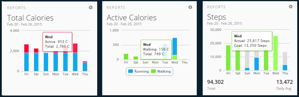

  • I don't even know where to start with the info on this grab from Connect.....although help getting the actual image to paste in this forum rather than just a link would be useful ;-)

  • Today (2015-03-10) is the first time that I've had an issue similar to those in this thread. I have a FR620 and a vivosmart. I have been wearing the vivosmart 24/7 (except for synching to GC via USB cable) since I received it as a gift in early January 2015. Before today, I have not had discrepancies in calories burned in GC (Garmin Connect) even though I wear both devices when I go for a run--at least one run was 12+ miles--but I do not use Activity Tracking on the vivosmart. It had appeared that GC recognized both devices referred to the same training data and used the FR620 calorie data. [I weigh daily and record it on GC; but, I had never synched my personal data to the devices since initially adding each to GC.]
    I have my GC acct synched with MFP (MyFitnessPal.com) and the two (GC & MFP) exchange data appropriately...or did until today after synching my training run, when I noticed a huge discrepancy from all the previous days. So, I looked back at GC and saw that it shows my Active calories ("=Total Calories - BMR") includes the FR620 data and the vivosmart data (which includes a huge number of calories for today's run). The calories in MFP do not agree with the Active calories in GC.
